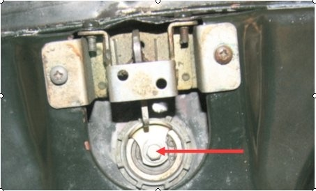

It transpired that the bolt on the underside of the boot lock (see picture) had worked loose allowing the catch plate to move causing it to no longer make contact with the unlock mechanism. With this bolt missing there is simply no way that the boot can be opened and all their luggage was still in the boot. “Don’t panic,” said Terry there must be a way.
It so happened that the owner of the hotel had a well-equipped workshop. After numerous tries with WD40 and a hammer and lots of head scratching, the problem was eventually solved by using an angle grinder. The lock was cut in three places and removed, causing some damage to the boot lid, resulting in a hefty repair bill for boot lid once back in the UK.
The warning therefore is to regularly make sure that this tiny insignificant bolt is tight – you have been warned.
