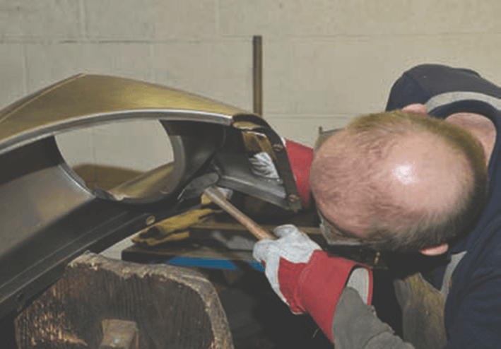

Restoration – Richard Chapman of Manor Garage MG Specialists (45mins) – This will be centred on an MGB GT body shell pre-restoration. Richard will go through how he would restore the shell and demonstrate how the various panels form the structure of the car. You will be able to identify all the areas of rust on an MGB and how they can be restored.

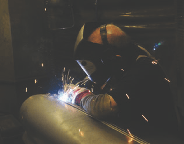

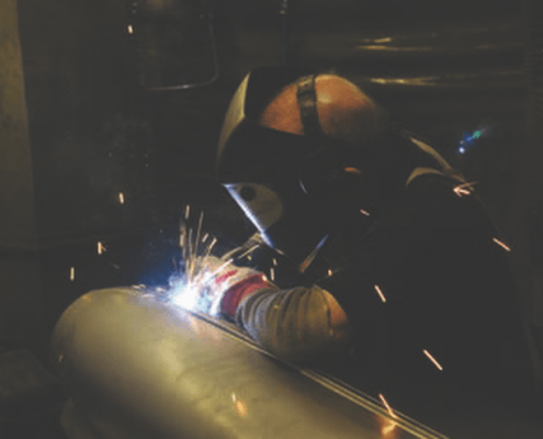

Welding – Graham Dix (45mins) – This will involve a demo of the most common welding technique for body restoration and an opportunity for you to practice your welding technique.

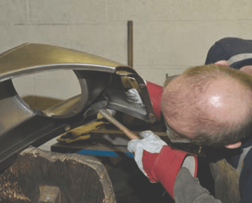

Panel work – BMH Staff (45mins) – This will involve a demonstration of how a body panel is prepared in respect of panel beating and finishing after pressing.
