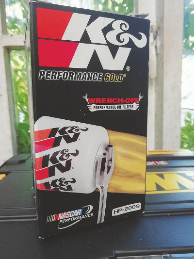

My B is sitting in the garage hooked up to the smart charger and going nowhere. We are getting out, however. Dogs need walking as well as extensive ball games in the yard and we do use the MG ZS, 1,200 miles since it was purchased at the end of January, using the old yardstick – is your journey really necessary? My MOT tester/service engineer rang me yesterday to assure me that he was still there, in spirit at least. We can delay the “voluntary” MOT this year and I have the bits for an oil change for the engine, gearbox and axle this time and (tying into Graham Dix’s thoughts and comments) a new K&N Oil filter which is double the size of the normal one. Moss part 235-830. Like Graham, I have changed the old Tecalmit oil filter system for a spin off cartridge type and this type hanging down still fits nicely in place.
