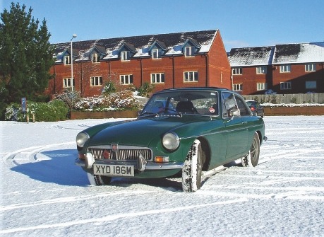

You could perhaps present two sides of the coin. If using your B regularly during the winter, improve the heating by fitting an 88 degree thermostat. You can also blank off the air intake with a piece of clear plastic, open the dash vents, put the fan on and re-circulate warm air through the matrix. Blanking off the oil cooler and 1/3 of the radiator when weather is cold also helps keep the engine happy. Douse the lower body and bumpers with clear anti-corrosion wax like Dynax UC. Remember to try some handbrake turns in Tesco’s car park when snowy to get a feel for grip limits.

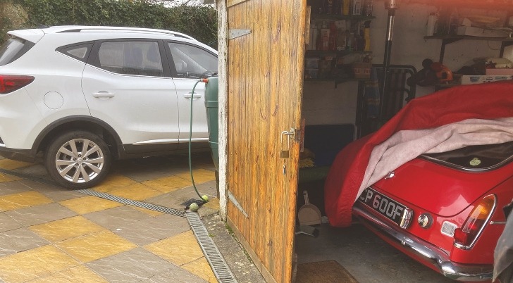

I keep mine under a suitable padded cover with a 60W tube heater under the sump and some windows open. A smart battery charger keeps the battery conditioned and the trickle discharge to the tracking device under control. A liberal squirt of WD40 on the chrome seems to do the necessary. Our new ZS does everyday duty.
