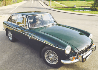

I own a 1972 MG BGT, B Register number 12461, purchased in August 1999.

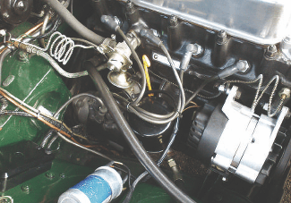

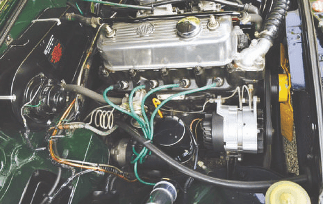

Well, I use the very simple device called IGNITOR which replaces the points and fits directly into the original Lucas distributor to my great satisfaction! It was easy to install, is invisible to all those experts who are far too picky when deciding to grant the next period of six years between MoT for what are officially defined as ‘Veteran’ vehicles here in Switzerland! I also installed a new Lucas coil. All that was required was to readjust the timing somewhat. That’s all done in less than an hour! Then last year I changed all the wire leads to and from the distributor, namely from the coil and to the spark plugs. I used copper leads, not the modern leads one finds today on the market, smartly coloured in green.
My, what a difference that made. Since then the engine (revised by Oselli some 20,000 kilometres ago!) runs like clockwork. The idle is stable and regular. Also, the engine pulls far better than before, especially in the lower revs. I can’t ask for more! By the way, the black plastic ‘box’ you may have clearly noticed to the left of the coil against the bulkhead on the ‘before’ photo hides all the electrical wires of the loom that looked so untidy in the engine bay… I found this at a truck trailer store. It is used to connect the trailer wiring leads to the tractor vehicle’s. It is a plastic box with two parts: the base screws onto the car and the lid screws down onto it. After emptying it of its multiple-point wire-connection rack, I just guided all the loose wires in at one end and out at the other!
