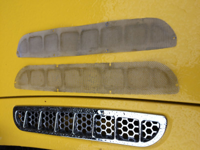

The fresh air intake legs never seem to quite match-up with the holes in the scuttle, so if you possibly can it's one of those jobs best done on a really hot day, when the small plastic holders will be as soft and flexible and forgiving as possible, and you'll only break as many as you absolutely have to. Try fitting the holders to the legs, and ever-so-gently easing them in together.
The air intake mesh comes in at least two different grades. Ashley Hinton feels any mesh restricts the flow of air, and therefor makes and recommends the alternative shown in the picture. Good luck!
https://www.ebay.co.uk/str/ashleyhinton ... 419&_pgn=1

I've never seen that mesh with the larger holes before. I certainly need a mesh as where I live there are a lot of trees and tree debris falls on the car quite often. I have had the fine mesh for years but, as you say, it must restrict the air flow. Is there a website for Ashley Hinton? The only one I can find has very little information on it.

Hi Mike,
I should have posted the Ashley Hinton link before - I've now added it to my original post, so the information is all in one place.
His price is for the complete unit - his perforated grill plate, the o/e frame that sits on top, and the plastic plugs to fit them to the scuttle.
He sells mostly through eBay, but he's in Great Bookham in Surrey so I saved myself the carriage costs by collecting from him in person ... and inevitably found a few more 'essential' items while I was there.
He's making lots of parts for MGs and other British cars in much the same way they were originally made, on the original presses, including the MGB heater tap.
Very highly recommended, and very helpful to deal with, and the sort of business it's a pleasure to support.
