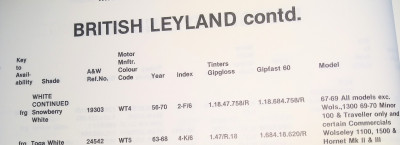

Andy, some further information. This is a page from the period A&W catalogue. It lists the codes for snowberry white and the tinters used in Gipgloss (the cellulose paint) and the tinters used in Gipfast 60.
Data, but probably not a great deal of use to you.
I probably have similar data from other manufacturers.
