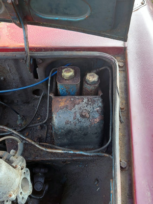

. brake master cylinder - single circuit which is pre '68.

Ian, not sure I understand all of your information, but one thing stands out: my 72 BGT has a single circuit brake system, correct, as it left Abingdon. Does that help?

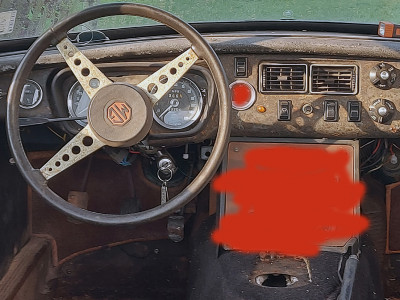

P.S. that dash looks remarkably similar to my 72 UK spec RHD car (apart from being LHD of course).

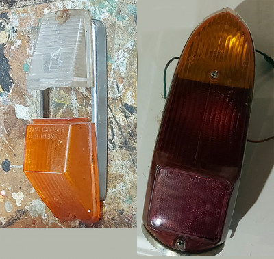

Are the plastic (blinkers) the same as well ?

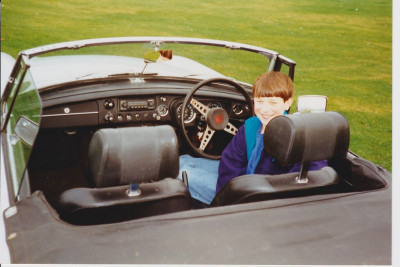

I have a 1971 B roadster chassis no. GHN5 253272. It is, and always has been a UK home market car. It has single circuit brakes, the later more angular rear light lenses, the same steering wheel as in your photo, and the same dashboard but with toggle switches rather than the rocker switches you have. Mine also has the same ignition switch position as yours, but it has no fresh air vents on the dash. The radio lives there on my car. Here's a photo taken more than 25 years ago. The child in the car is now 39 years old!

Your dashboard, switches, steering wheel, ignition switch position etc. all look exactly the same as my 72 BGT. The sidelights/indicators are also identical.
Like Mike's car (previous post) the rear light clusters on my BGT have more angular rear light lenses. Yours look to be the earlier rounded design, but they are fully interchangeable. Yours might be original or could have been all that was available when the PO replaced them.

With British Leyland firmly in charge at the time , the 1972 model MGB (production would have started in Sept 71) saw the introduction a number of changes.
Introduction of rocker switches instead of toggle switches, fresh air vents where the radio used to fit and a new central console to house the Radio, interior light and cigarette lighter. You should have a second part to the console that continues down the transmission tunnel with a gaiter around the gear lever, ashtray and lift up armrest.
The lights and steering wheel in your picture are correct for a 72 car. The Single line braking circuit was retained until late 1975, even some early rubber bumper cars have this.
So in conclusion I think this all points to supporting the BMH build date of Jan 72.
