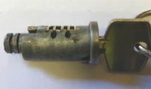

Picture 1 shows the cylinder without the key, and the five spring loaded ‘pins’ are extended and stop the cylinder rotating in the barrel.

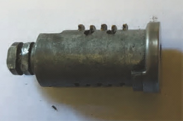

Picture 2 shows the key inserted, and the five ‘pins’ should all be flush with the surface to allow the cylinder rotate in the barrel.

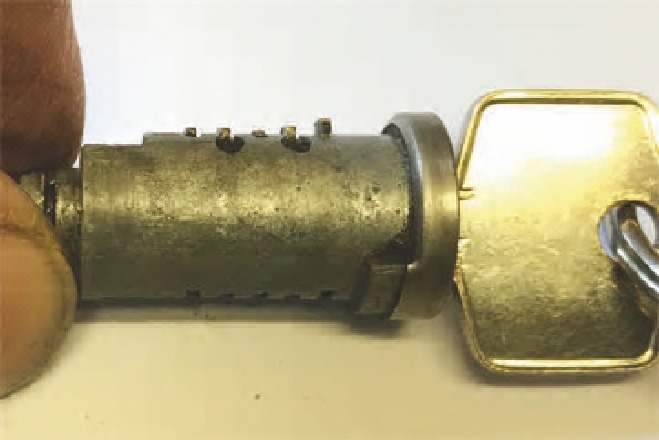

Picture 3 – After a quick grind to those ‘pins’ still extended and now the same key works all locks!
There is still enough length on the ‘pins’ to stop the cylinder rotating without the key, although it may make picking the lock easier – but who is to know!
