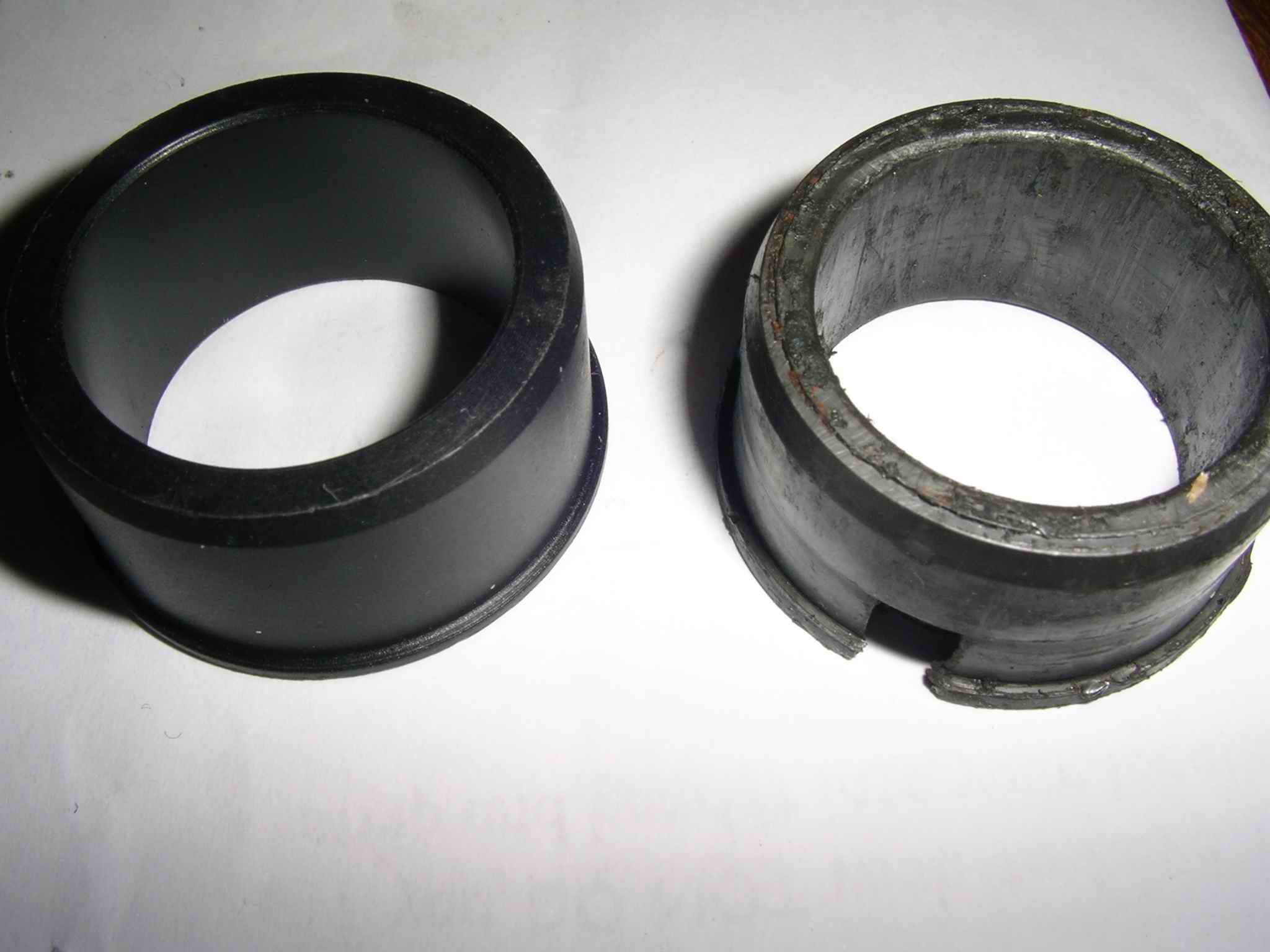

I am in the process of rebuilding my steering column - the semi-collapsible type - and thought I would replace the top and bottom plastic bushes. Just received two from a well known supplier (not Moss) and I find the internal and external dimensions of the bottom bush way too big (loose on the column and will not fit into the housing on the external column).
Anyone found any bushes which fit, or any advice? I may well just reuse the old original bushes!

Just as a further thought and a bit of information which may be of assistance to fellow MGB owners:

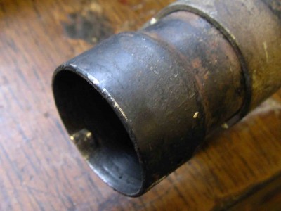

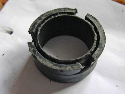

# The original lower steering column bush (semi-collapsible column 1972 MGBGT) consists of a double skin structure with cut-outs which locate the bush in indents in the outer steering column shaft. This double skin does allow some flexibility for a very snug fit inside the outer steering column. See photographs attached which I think should be self explanatory.
# The dimensions of the original lower steering column bush to fit the column are - internal diameter 25.6mm, external diameter 33.3mm
# The replacement bushes on sale generally (as far as I can ascertain) - Part No MPB1002, are all similarly made from a single piece of very hard plastic. The dimensions of this bush are internal diameter 26.5mm, external diameter 34.5mm. This lack of flexibility and these dimensions mean that this bush is far too loose on the inner column, and cannot be fitted into the recess of the outer column. Additionally there are no cut-outs on the bush to locate in the indents of the outer column.
It is of course possible (although very unlikely?) that my 1972 BGT has a steering column of slightly different dimensions to most others, and that these replacement bushes do generally fit the majority of Bs. Would be interesting to know.
I am also repairing the sliding (collapsing) joint on my column using the hot glue method as recommended by Gerry Masterman in the USA, if anyone wishes to have more information on this.
Hope this may be of some use/assistance,
IanF
