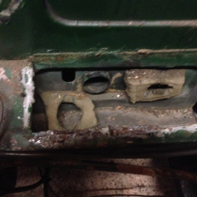

PS - When I removed my heater for a refub, in place of the rubber block were two pieces of seat foam which someone had cut holes into to meet the vents. It seems to work fine and was no trouble to re-fit.
