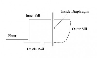

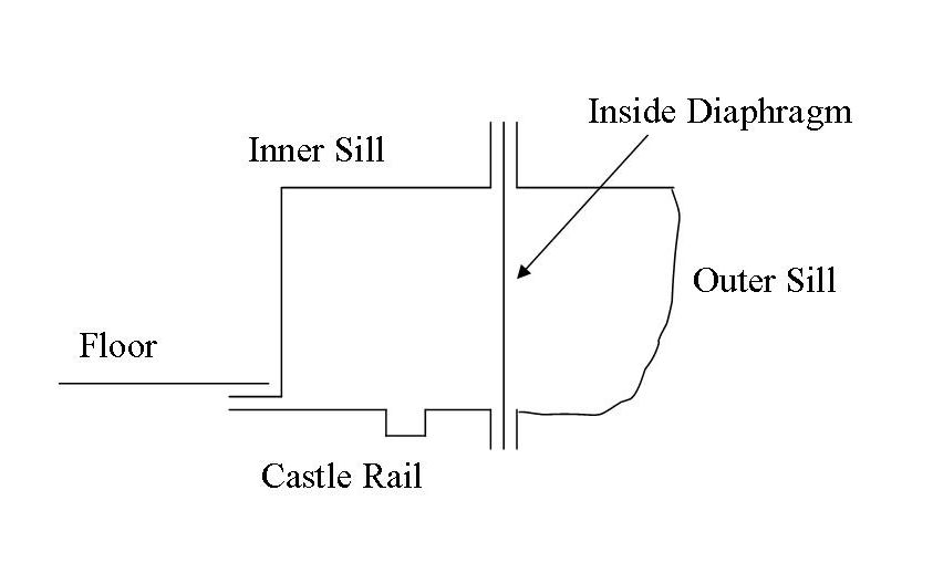

There are many places these cars rot, for example, inside the front wings both above the headlights and at the rear of the wing high up. You mention the sills, but do you realise that the sill goes from the front wheel arch right back to the rear wheel arch. The front and rear parts are covered by the outer wings - a grand place for rot to start. Under the sill is the strength of the car in the so-called castle rail, an upside down top-hat section. I am attaching a sketch of a cross-section through the sill which might be useful. Then there's the rear chassis rails, the tops of the wings where the steel beading is inserted - I could go on. Yes, if you can find someone who understands the problems to go with you jump at the chance. Don't get sold a lemon.
Thanks for taking the time to reply - every bit of information I can get is helpful. I think my plan is to purchase from either a reputable specialist or someone within the club. This of course doesn't guarantee that a car is rust free, but should hopefully be a better starting point.
